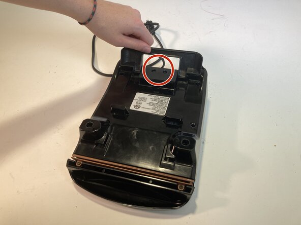

    12. George Foreman GRS040BC Disassembly: step 12, image 1 of 2 George Foreman GRS040BC Disassembly: step 12, image 2 of 2
      • Remove the two 12mm screws found on the casing under the black stand using a TR6 Torx screwdriver.
      Ask FixBot
    13. George Foreman GRS040BC Disassembly: step 13, image 1 of 2 George Foreman GRS040BC Disassembly: step 13, image 2 of 2
      • Remove the casing and the stand, which will clip off, to reveal the wiring.
