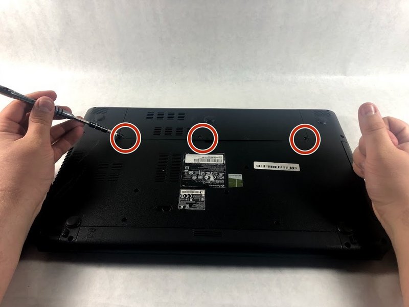

    1. Gateway NE52214U Hard Drive Replacement, Hard Drive: step 1, image 1 of 1
      • Make sure that your laptop is powered down and turned off.
      • Flip the laptop over so the backside is facing you.
      • Remove the three 7mm screws using the Phillips #1 screwdriver.
