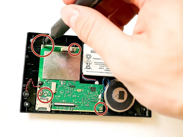

    2. Garmin Nuvi 2559 Power Button Replacement: step 6, image 1 of 1
      • Remove the four 3.5 mm screws from the motherboard using a Phillips #1 screwdriver.
      • Be careful not to damage the motherboard since it is very fragile.
      Ask FixBot
