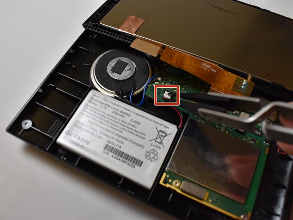

  4. Garmin Nuvi 2559 Battery Replacement: step 4, image 1 of 3 Garmin Nuvi 2559 Battery Replacement: step 4, image 2 of 3 Garmin Nuvi 2559 Battery Replacement: step 4, image 3 of 3
    • Pry the battery from the adhesive using the black nylon spudger as leverage.
    • Disconnect the wire from the motherboard using tweezers.
    • Remove the battery.
    • Be careful not to damage the motherboard when removing the battery.
