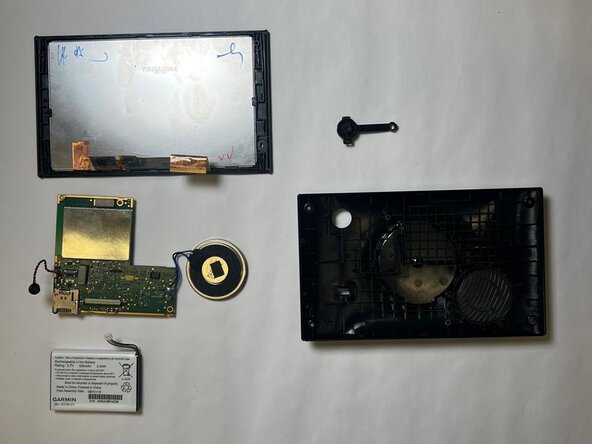

  8. Garmin Nuvi 2559 Backplate Replacement: step 8, image 1 of 2 Garmin Nuvi 2559 Backplate Replacement: step 8, image 2 of 2
    • Use the black nylon spudger to remove the motherboard and connecting speaker.
    • If you don’t plan to replace the speaker, you will need to disconnect the wires that connect it to the motherboard and solder them back in place during reassembly.
    Ask FixBot
  9. Garmin Nuvi 2559 Backplate Replacement, Power Button: step 9, image 1 of 1
    • Pry the battery from the adhesive using the black nylon spudger as leverage.
    Ask FixBot
  10. Garmin Nuvi 2559 Backplate Replacement: step 10, image 1 of 2 Garmin Nuvi 2559 Backplate Replacement: step 10, image 2 of 2
    • Remove the power button.
    Ask FixBot
  11. Garmin Nuvi 2559 Backplate Replacement, Backplate: step 11, image 1 of 2 Garmin Nuvi 2559 Backplate Replacement, Backplate: step 11, image 2 of 2
    • Remove the back plate.
    Ask FixBot
