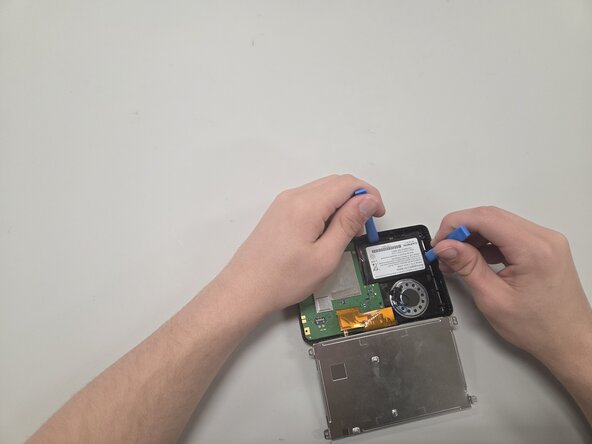

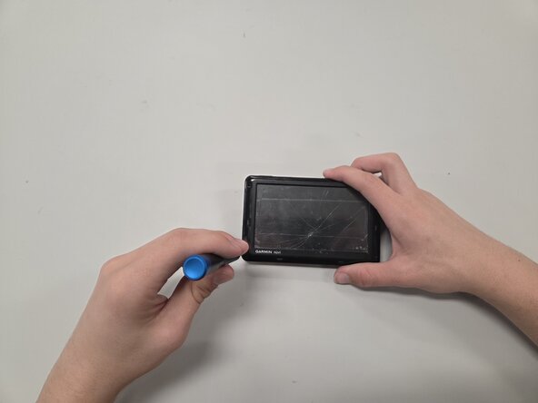

      • Remove the gray bezel with an opening pick.

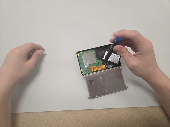

      • Remove the black bezel with an opening pick.

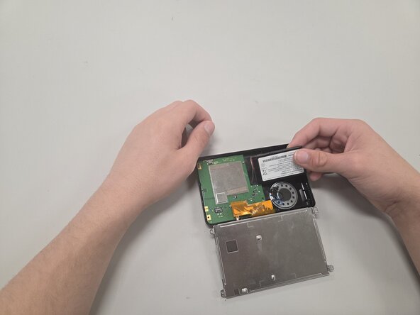

      • Caution: The battery itself is double-taped to the assembly, so it will take time and care to remove it without damage.
      • Remove the battery slowly by using an opening tool to pry the underside of the battery, and use another opening tool as leverage to lift the battery slowly. After some time, you should have the battery free from the frame.
