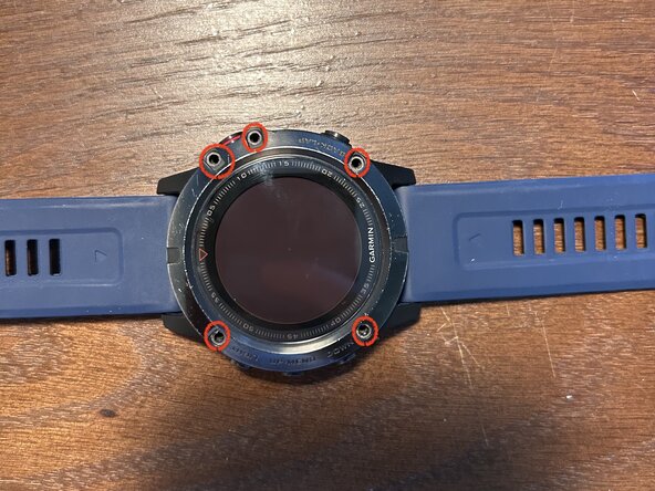

      • Remove the five screws surrounding the display using a Torx T7 bit.
      • Please take note of how tight they are so you can achieve the same torque during final reassembly.
      • Carefully lift up the display. Be careful not to pull too hard on the ribbon cable so you do not damage the cable or the main board connector.

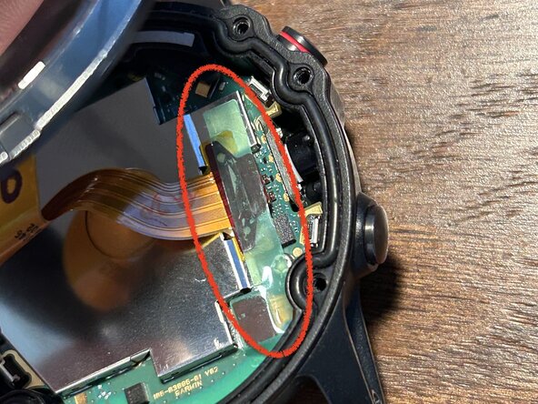

      • Remove the green sticker covering the two press-fit connectors.
      • Save this for later; you might be able to reinstall it at the end of the repair. If not, no worries, the watch works fine without it.

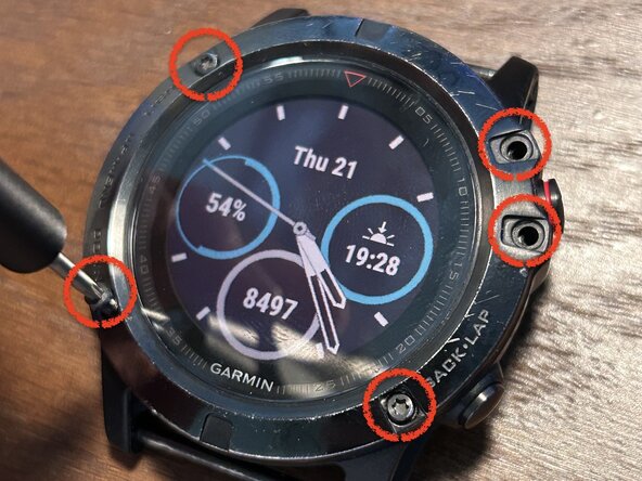

      • Remove the display ribbon cable press-fit connector of the old display.
      • Connect the new display. Ensure that you press the connector down fully.
      • (optional) If you are able to replace the small green sticker covering the press connectors for the ribbon cables, do this now.

      • Insert all 5 screws around the bezel of the watch.
      • First, gently tighten all screws, and then proceed to fully tighten opposite pairs at a time to ensure a proper and complete seal.
      • Do not over-tighten screws; try to achieve the same torque as you noticed at the start of the repair. Check around the edge where the two pieces meet; at most, you should see a hairline gap.
