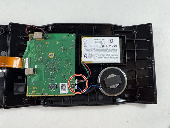

    1. Garmin DriveSmart 71 EX Power Button Replacement, Power Button: step 4, image 1 of 2 Garmin DriveSmart 71 EX Power Button Replacement, Power Button: step 4, image 2 of 2
      • Use tweezers to disconnect the battery and speaker connectors from their motherboard sockets.
      • Using tweezers is optional. If you remove the wires by hand, be careful not to damage them.

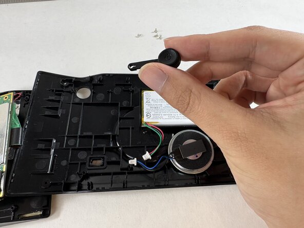

    3. Garmin DriveSmart 71 EX Power Button Replacement: step 6, image 1 of 3 Garmin DriveSmart 71 EX Power Button Replacement: step 6, image 2 of 3 Garmin DriveSmart 71 EX Power Button Replacement: step 6, image 3 of 3
      • Lift up the motherboard to expose the power button. Take care not to strain the connected ribbon cable.
      • Remove the power button.
