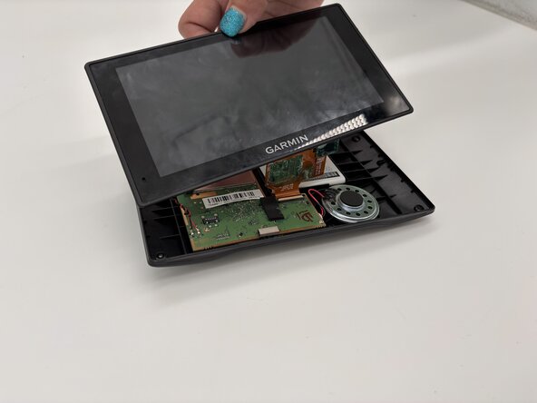

  2. Garmin DriveSmart 60 LMT Motherboard Replacement: step 2, image 1 of 2 Garmin DriveSmart 60 LMT Motherboard Replacement: step 2, image 2 of 2
    • Insert a plastic opening tool into the seam between the rear case and chassis.
    • Pry around the perimeter until the rear case fully releases.
    • Take your time and work slowly to avoid damaging the clips or the casing.
    • Remove the rear case.

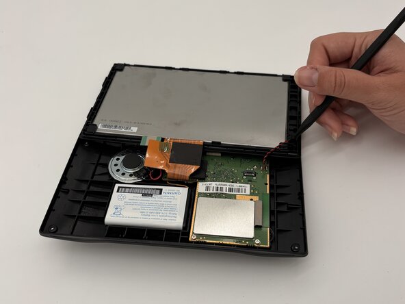

  3. Garmin DriveSmart 60 LMT Motherboard Replacement: step 3, image 1 of 2 Garmin DriveSmart 60 LMT Motherboard Replacement: step 3, image 2 of 2
    • Use a spudger to gently disconnect the black and red wires (ZIF connector) from the socket on the screen assembly. Take care not to pull on the wires or damage the connector.
    Ask FixBot
  4. Garmin DriveSmart 60 LMT Motherboard Replacement: step 4, image 1 of 2 Garmin DriveSmart 60 LMT Motherboard Replacement: step 4, image 2 of 2
    • Gently lift the white clamp to release the ZIF Connector, which is the orange ribbon cable, and carefully unsnap it from the connector.
    • Avoid using too much force to prevent damage to the ribbon or the clamp.
