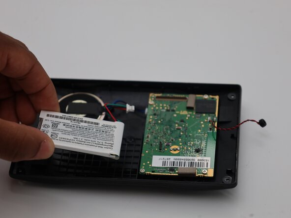

    1. Garmin DriveSmart 50 LMTHD Battery Replacement, Battery: step 6, image 1 of 3 Garmin DriveSmart 50 LMTHD Battery Replacement, Battery: step 6, image 2 of 3 Garmin DriveSmart 50 LMTHD Battery Replacement, Battery: step 6, image 3 of 3
      • Unplug the connector that is connected from the battery to the circuit board using tweezers.
      • Use the spudger tool to gently remove the battery from the adhesive pad and use your hands to fully remove it.
