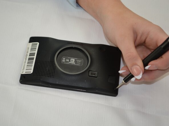

  1. Garmin DriveSmart 50 LMT Speaker Replacement, Speaker: step 1, image 1 of 1
    • Use a T5 Torx screwdriver to remove the four screws from the bottom case.

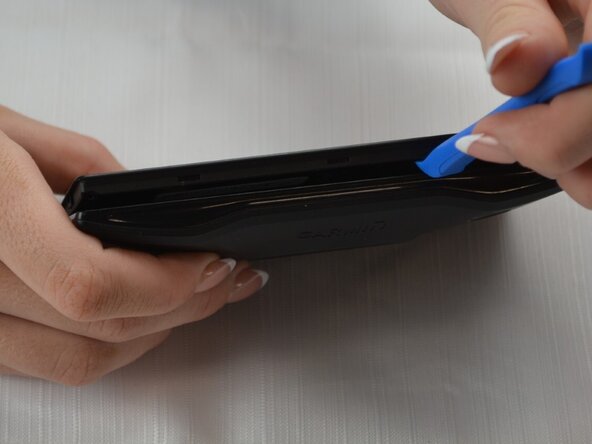

  2. Garmin DriveSmart 50 LMT Speaker Replacement: step 2, image 1 of 2 Garmin DriveSmart 50 LMT Speaker Replacement: step 2, image 2 of 2
    • Insert an opening tool into the seam between the top and bottom case.
    • Slide it around the perimeter of the device to release the clips holding them together.
    • Separate the top and bottom of your GPS.
