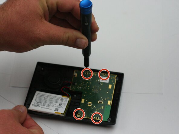

    1. Garmin Drive 53 EX Power Button Replacement, Power Button: step 4, image 1 of 1
      • Insert an opening tool underneath the battery.
      • Slowly and carefully, raise the battery to remove it from the device.
      Ask FixBot
    2. Garmin Drive 53 EX Power Button Replacement: step 5, image 1 of 1
      • Remove the four screws from the motherboard.
      Ask FixBot
    3. Garmin Drive 53 EX Power Button Replacement: step 6, image 1 of 1
      • Carefully disconnect the wire connecting the battery to the motherboard.
      Ask FixBot
    4. Garmin Drive 53 EX Power Button Replacement: step 7, image 1 of 1
      • Insert an opening tool underneath the power button.
      • Slowly lift and remove the power button.
      Ask FixBot
