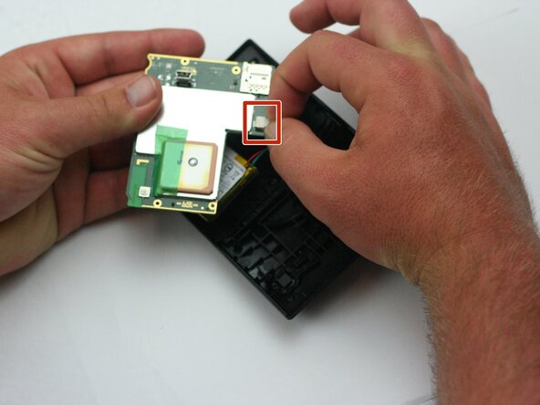

    1. Garmin Drive 53 EX Battery Replacement, Battery: step 4, image 1 of 1
      • Insert an opening tool underneath the battery.
      • Slowly and carefully, raise the battery to remove it from the device.
      Ask FixBot
    2. Garmin Drive 53 EX Battery Replacement: step 5, image 1 of 1
      • Carefully disconnect the wire connecting the battery to the motherboard.
      Ask FixBot
    3. Garmin Drive 53 EX Battery Replacement: step 6, image 1 of 1
      • Remove the battery from the device.
      Ask FixBot
