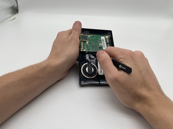

  5. Garmin Drive 50 LM Speaker Replacement, Speaker Replacement: step 5, image 1 of 3 Garmin Drive 50 LM Speaker Replacement, Speaker Replacement: step 5, image 2 of 3 Garmin Drive 50 LM Speaker Replacement, Speaker Replacement: step 5, image 3 of 3
    • Gently pull on the blue cord on the left of the motherboard with your tweezers until it is disconnected.

  6. Garmin Drive 50 LM Speaker Replacement: step 6, image 1 of 3 Garmin Drive 50 LM Speaker Replacement: step 6, image 2 of 3 Garmin Drive 50 LM Speaker Replacement: step 6, image 3 of 3
    • Once the speaker is disconnected, gently pull on the speaker until it comes out of the case.
    • The speaker will be connected to the case via adhesive, so it could be sticky if touched.
