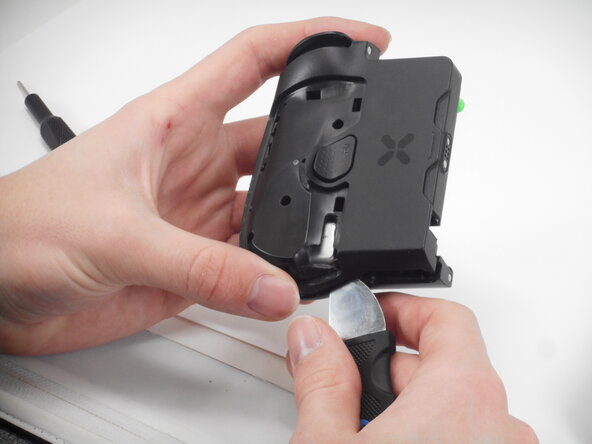

    5. Gamesir X4 Aileron Back Cover Replacement: step 5, image 1 of 3 Gamesir X4 Aileron Back Cover Replacement: step 5, image 2 of 3 Gamesir X4 Aileron Back Cover Replacement: step 5, image 3 of 3
      • Use a Jimmy to pry the entire controller in half to separate the 2 components. Slowly work your way around the controller, working the Jimmy through the separate the halves.
      • Take care not to strain or damage the connected ribbon cable.
      • Flip up the black locking flap securing the ribbon cable.
      • Disconnect the ribbon cable.
