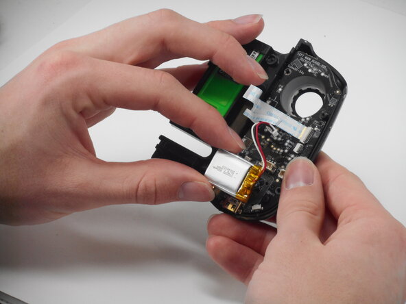

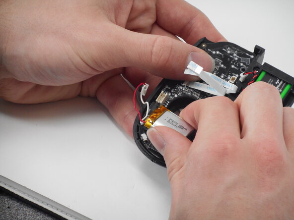

  7. Gamesir X4 Aileron Action Buttons Replacement, Battery: step 7, image 1 of 1
    • Disconnect the battery connector by lifting it straight up and out of its socket.
    Ask FixBot
  8. Gamesir X4 Aileron Action Buttons Replacement: step 8, image 1 of 1
    • Pull out the battery by hand.
    • The battery is secured with a mild adhesive.

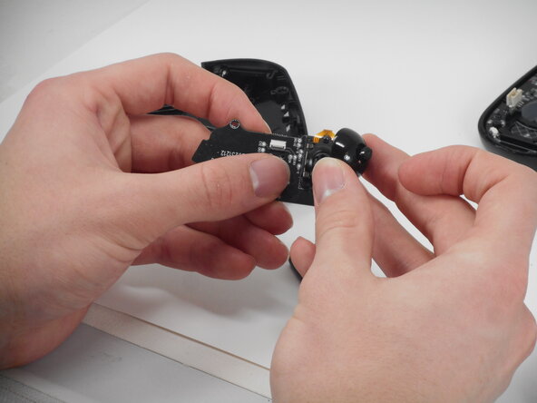

  16. Gamesir X4 Aileron Action Buttons Replacement: step 16, image 1 of 1
    • Use a Phillips screwdriver to remove the two 4.1 mm screws securing the joystick module.
    • Remove the joystick module.
    Ask FixBot

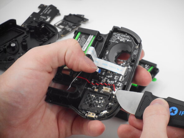

  17. Gamesir X4 Aileron Action Buttons Replacement, Action Buttons: step 17, image 1 of 1
    • Flip up both of the black locking flaps securing the two ribbon cables.
    • Disconnect the ribbon cables.
    Ask FixBot
  18. Gamesir X4 Aileron Action Buttons Replacement: step 18, image 1 of 1
    • Disconnect the black and red twisted cable from the right main board.
    Ask FixBot
