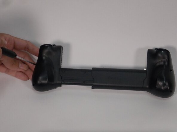

    1. GameSir X5 Lite Trigger Replacement, Trigger: step 1, image 1 of 3 GameSir X5 Lite Trigger Replacement, Trigger: step 1, image 2 of 3 GameSir X5 Lite Trigger Replacement, Trigger: step 1, image 3 of 3
      • Use a Phillips #00 screwdriver to remove the four 8 mm screws located on the back cover.

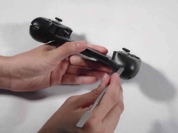

    3. GameSir X5 Lite Trigger Replacement: step 3, image 1 of 1
      • Use an opening pick to loosen the back cover to reach the end of the extender.
