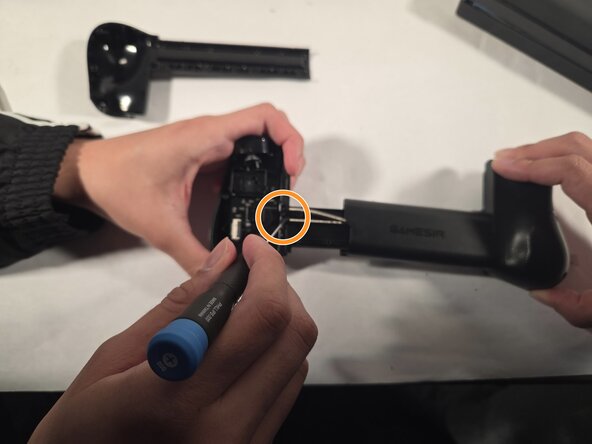

    4. GameSir X5 Lite Joystick Replacement: step 4, image 1 of 2 GameSir X5 Lite Joystick Replacement: step 4, image 2 of 2
      • Fully extend the extender to reach the last two 5 mm screws.
      • Remove the last two 5 mm screws with a Phillips #00.
      • Remove the springs to separate the two sides of the controller by unscrewing two 5 mm Phillips #00 screws.

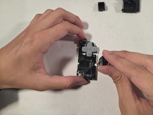

    7. GameSir X5 Lite Joystick Replacement: step 7, image 1 of 2 GameSir X5 Lite Joystick Replacement: step 7, image 2 of 2
      • Disconnect the old joystick by carefully using a metal spudger/opening tool to lift the locking flap that connects the ZIF Connector, then disconnect the ZIF Connector and connect the new ZIF Connector by using a metal spudger/opening tool to lock the flap downward.
