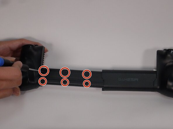

    2. GameSir X5 Lite Action Button Replacement: step 2, image 1 of 1
      • Extend the controller and remove the six 5 mm screws off the back of the extender using Phillips #00 screwdriver.
