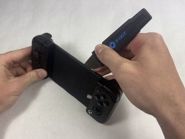

    1. GameSir X2 Pro Bumper Replacement, Bumper: step 1, image 1 of 1
      • Insert the tip of the Jimmy between the rubber pad and the back of the controller, then slide it along the edge to loosen the adhesive and lift the pad away.
      • Gently remove the rubber pad.

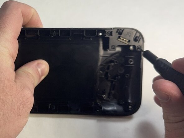

    5. GameSir X2 Pro Bumper Replacement: step 5, image 1 of 3 GameSir X2 Pro Bumper Replacement: step 5, image 2 of 3 GameSir X2 Pro Bumper Replacement: step 5, image 3 of 3
      • Use a Phillips #000 screwdriver to remove the three 4.5 mm screws from top right of the back panel.
