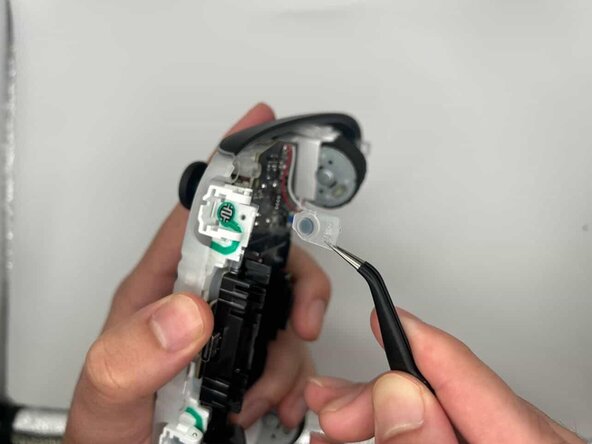

  6. GameSir Super Nova Triggers Replacement: step 6, image 1 of 3 GameSir Super Nova Triggers Replacement: step 6, image 2 of 3 GameSir Super Nova Triggers Replacement: step 6, image 3 of 3
    • With tweezers, carefully push the pin out holding the trigger module.
    Ask FixBot
  7. GameSir Super Nova Triggers Replacement: step 7, image 1 of 2 GameSir Super Nova Triggers Replacement: step 7, image 2 of 2
    • Remove the trigger.
