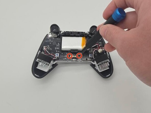

    3. GameSir Super Nova Charging Port Replacement: step 5, image 1 of 2 GameSir Super Nova Charging Port Replacement: step 5, image 2 of 2
      • Remove the 5 mm screws on either side of the charging port using a Phillips #00 screwdriver.
      Ask FixBot
    4. GameSir Super Nova Charging Port Replacement: step 6, image 1 of 2 GameSir Super Nova Charging Port Replacement: step 6, image 2 of 2
      • Remove the charging port contacts.
      Ask FixBot
To reassemble your device, follow these instructions in reverse order
