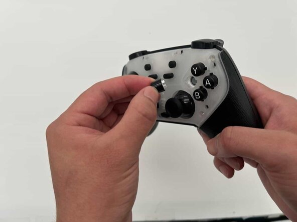

    1. GameSir Super Nova Battery Replacement, Joystick Caps and Action Buttons: step 2, image 1 of 3 GameSir Super Nova Battery Replacement, Joystick Caps and Action Buttons: step 2, image 2 of 3 GameSir Super Nova Battery Replacement, Joystick Caps and Action Buttons: step 2, image 3 of 3
      • Remove the interchangeable buttons and joystick caps from the controller by pulling them up.

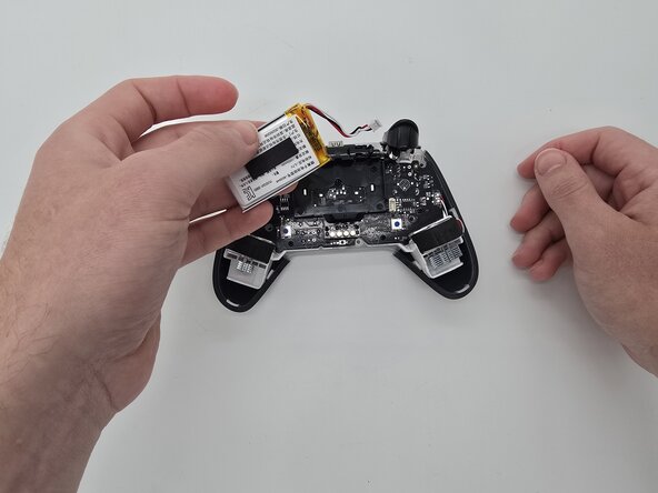

    3. GameSir Super Nova Battery Replacement: step 5, image 1 of 1
      • Using your fingers, disconnect the battery's connector from the socket.
      Ask FixBot
    4. GameSir Super Nova Battery Replacement: step 6, image 1 of 1
      • Remove the battery.
