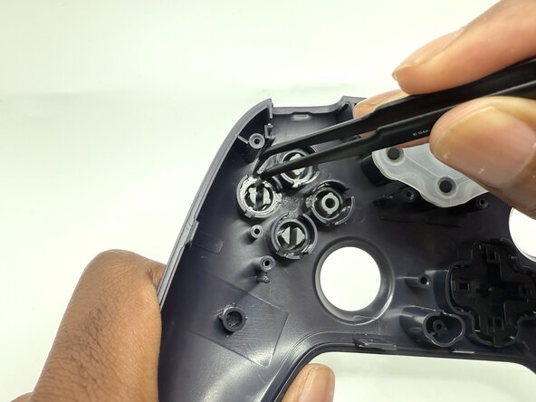

  8. GameSir Nova Lite Action Buttons Replacement: step 8, image 1 of 1
    • After removing the motherboard, hold the front shell of the controller.
    • Do not flip the front shell of the controller to the front, or all the buttons will fall out.
    Ask FixBot
  9. GameSir Nova Lite Action Buttons Replacement: step 9, image 1 of 2 GameSir Nova Lite Action Buttons Replacement: step 9, image 2 of 2
    • Use angled tweezers to take the action buttons outside of their sockets.
    Ask FixBot
