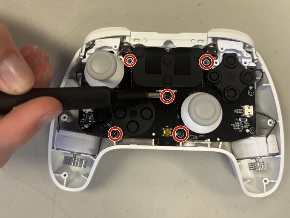

  4. GameSir G7 SE Motherboard Replacement: step 4, image 1 of 1
    • Remove the five 4 mm-long Phillips screws.
    Ask FixBot
