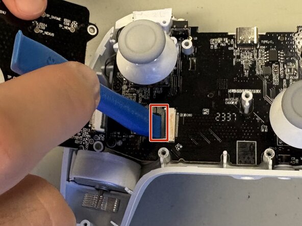

GameSir G7 SE Daughterboard Replacement
  1. GameSir G7 SE Daughterboard Replacement, Daughterboard: step 1, image 1 of 1
    • Wedge an opening tool into the seam between the face plate nad chassis at the top of the controller.
    • Lift the faceplate off of the controller.
    Ask FixBot
  2. GameSir G7 SE Daughterboard Replacement: step 2, image 1 of 1
    • Remove the six 9.2 mm-long screws located around the face of the controller with a T6 Torx screwdriver.
    Ask FixBot
  3. GameSir G7 SE Daughterboard Replacement: step 3, image 1 of 1
    • Wedge an opening tool under the faceplate to remove it.
    Ask FixBot
  4. GameSir G7 SE Daughterboard Replacement: step 4, image 1 of 1
    • Remove the 4 mm-long screws located on the daughterboard with a Phillips #0 screwdriver.
    Ask FixBot
  5. GameSir G7 SE Daughterboard Replacement: step 5, image 1 of 1
    • Wedge the spudger under the flap that is holding the daughterboard.
    • Lift the flap up with the spudger and take the daughterboard out.
