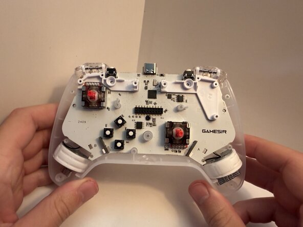

  11. GameSir Cyclone 2 Rumble Motors Replacement: step 11, image 1 of 1
    • Use a Phillips #00 screwdriver to remove the single screw in the center of the motherboard.
    • Remove the motherboard from the controller case.
    Ask FixBot
  12. GameSir Cyclone 2 Rumble Motors Replacement: step 12, image 1 of 2 GameSir Cyclone 2 Rumble Motors Replacement: step 12, image 2 of 2
    • Disconnect the battery connector from the socket on the motherboard.
    • Remove the battery.
    Ask FixBot
  13. GameSir Cyclone 2 Rumble Motors Replacement, Rumble Motors: step 13, image 1 of 2 GameSir Cyclone 2 Rumble Motors Replacement, Rumble Motors: step 13, image 2 of 2
    • The motors are located inside the handles, on the bottom left and right.
    • Disconnect the rumble motor connector by pulling the connector straight out.
    • The motors (or the counterweights) are of different sizes. From the front:
    • The motor with the small counterweight attaches to the left side of the controller.
    • The motor with the large counterweight attaches to the right side of the controller.
