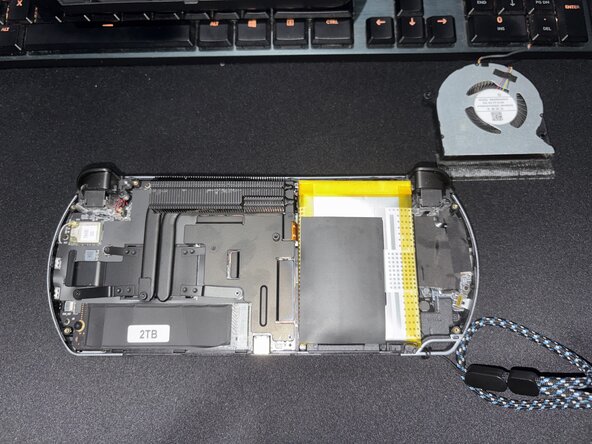

I recently encountered a spicy pillow (swelling battery) in my GPD WIN 4 and it needed replacing,
It was a bit tricky at first but with a prying tool and a size 00 Phillips screwdriver (I used the PH00 bit from the iFixit kit) it was relatively easy

    5. GPD WIN 4 (2023) Battery Replacement: step 5, image 1 of 2 GPD WIN 4 (2023) Battery Replacement: step 5, image 2 of 2
      • there are 3 screws in the main heatsink, left, top and bottom that have to come out.
      • Once the screws are removed the heatsink can come out exposing the battery connector.
      Ask FixBot
    6. GPD WIN 4 (2023) Battery Replacement: step 6, image 1 of 1
      • Next is the hard part, disconnect the battery connector, like a little Lego, then carefully pry the battery from the case, this has double sided tape with no removal strips. I used an old sim carrier card (the smooth side)
      • Once the battery is out, this is the perfect opportunity to replace the SSD and remove dust from the fan and heatsink.
      Ask FixBot
