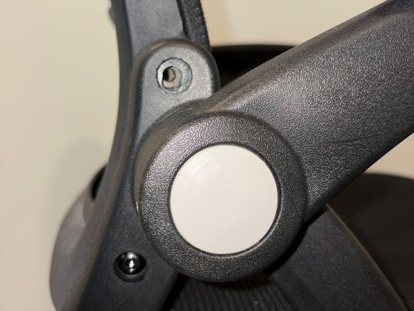

    1. GERTTRONY Seat Replacement, Seat: step 1, image 1 of 3 GERTTRONY Seat Replacement, Seat: step 1, image 2 of 3 GERTTRONY Seat Replacement, Seat: step 1, image 3 of 3
      • Carefully remove the four black screw covers from the sides of the chair arms (two per armrest) using a spudger or your fingers.

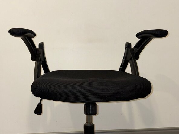

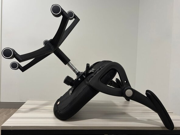

    4. GERTTRONY Seat Replacement: step 4, image 1 of 2 GERTTRONY Seat Replacement: step 4, image 2 of 2
      • Push the chair arms upward into the upright position.
      • Carefully flip the chair upside down onto a stable surface (a table or the floor works).
      • Be careful when flipping the chair. Ask another person for help if needed.

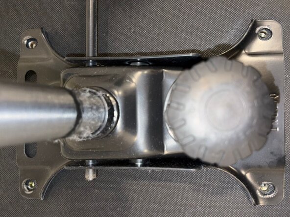

    5. GERTTRONY Seat Replacement: step 5, image 1 of 3 GERTTRONY Seat Replacement: step 5, image 2 of 3 GERTTRONY Seat Replacement: step 5, image 3 of 3
      • The tilt mechanism underneath the seat will now be visible.
      • Use the 5 mm Allen key to remove the four 30.0 mm screws (two under each arm).
