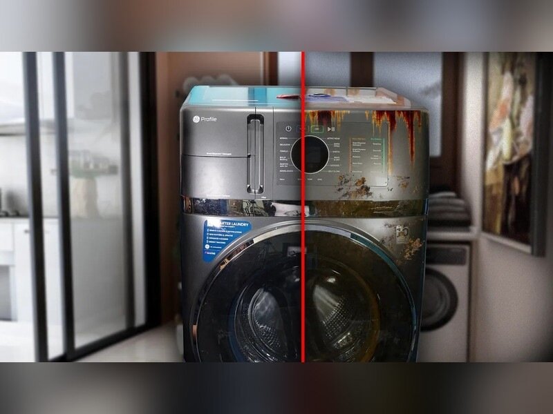

GE UltraFast Combo Washer Dryer Maintenance
Video Guide This guide was transcribed from a YouTube video.
Introduction
Go to step 1 ↓
Routine maintenance keeps the heat-pump airflow path clear, reduces odors and mold, and helps the GE UltraFast Combo Washer Dryer dry at normal speed. Use this guide to clean the lint system, filters, drawers, gasket, drum, and drain pump on a regular schedule.

Regular upkeep keeps the heat-pump system clear, preserves fast drying times, and extends the life of your appliance.
