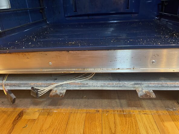

      • With the doors removed you can access the screws that hold the lower access panel. It has 3 Phillips screws in the top and 3 in the bottom. To get to those in the bottom, you will need a very short-handled screw driver.
      • You will need to lie on the floor to see the screws in the bottom. These screws hold the access panel to three tabs that stick out from the oven. The third photo shows one of these tabs, once the panel has been removed
      • With the screws removed, you can pull the access panel away from the oven face.

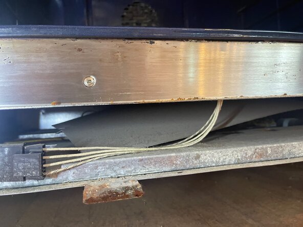

      • The baking element has a black wiring harness connection to the oven's electronics. Lift the tab on the harness so you can slide the connection apart

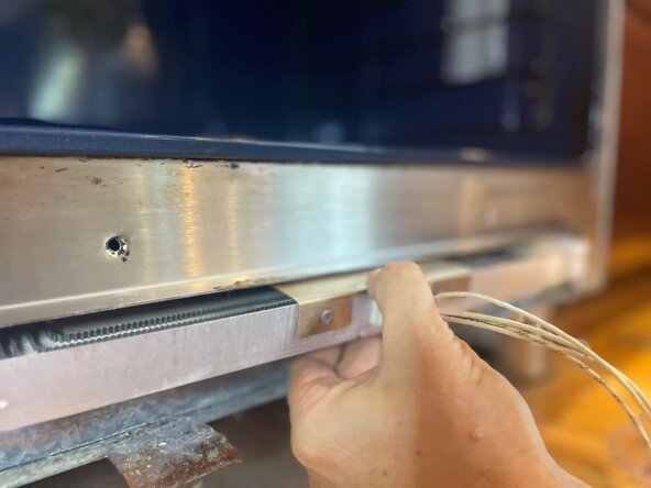

      • The baking element rests inside an aluminum holder whose cover is screwed to the face of the oven. There are two Phillips screws that hold the hidden baking element in place against the bottom of the oven. Remove these screws.
      • The front of the baking element will drop down so you can access its cover.

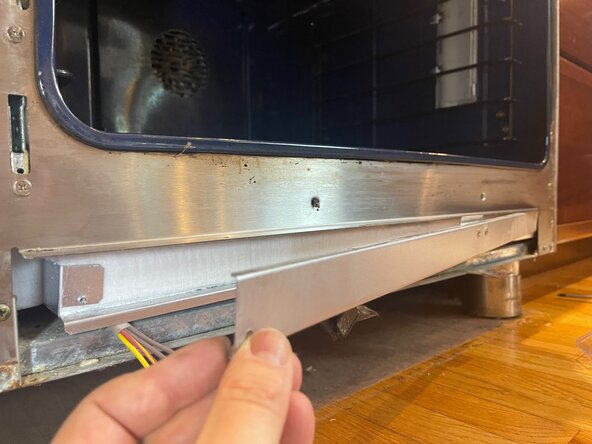

      • The baking element is behind an aluminum cover that has one 1/4" screw on the left side. You will need a socket wrench to remove it.
      • Pull the left side of the cover away from the oven. The right side has a tongue that sits in a slot in the oven wall.
      • With the cover removed, you can see the white fluffy insulation behind which is the baking element.
