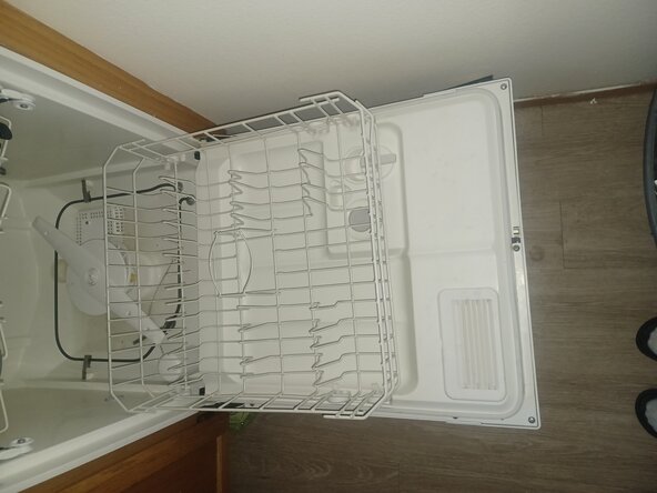

    • Pull the lower dish rack straight out of the dishwasher tub.
    • Lift the dish rack upward to disengage it from the track stops.
    • Remove the dish rack from the dishwasher and set it aside.

    • Position the lower dish rack onto the track rails.
    • Slide the dish rack fully into the dishwasher tub.
    • Ensure the dish rack moves smoothly along the tracks.
    • Spin the spray arm by hand to confirm it rotates freely before closing the dishwasher door.
