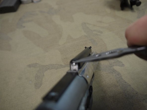

  5. G&G TR16 R4 Airsoft Reassembly: step 5, image 1 of 2 G&G TR16 R4 Airsoft Reassembly: step 5, image 2 of 2
    • If you somehow managed to get everything aligned perfect great, but 9 times out of ten this will not be the case. If so fallowing will allow you to line up problem parts hopefully without re-opening the gearbox.
    • Use your small thin tools to re-position problem parts if possible.
    • First with the gearbox held together by hand, check for proper wire and safety-latch placement.
    • Then try to make sure you have the spring guide in place. If so then you can keep holding the two haves together.
    • At this point check to see if the gear and anti reversal-latch axles are placed in the bearing, if not you can manipulate the position of these parts with a small thin tool. If the anti-reversal latch is too far out of position you might have to take the gearbox apart again and retry step 3 and 4.
    • If all the parts covered so far look like they are in position but the gearbox is still slightly cracked open it is most likely the piston. Luckily there is a trick to dealing with this. Which will be step 6.
    Ask FixBot
    • Wile holding the gearbox together take a long driver that fits down the cylinder head preferably with a flat bottom ( a 2.5mm hex driver is perfect) and push the piston back. The piston will most likely snap right into place.
    Ask FixBot

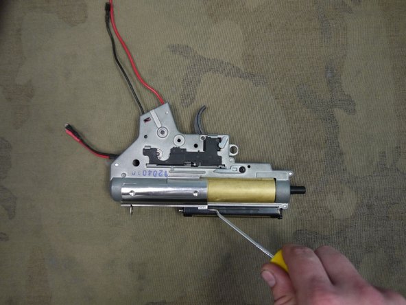

  6. G&G TR16 R4 Airsoft Reassembly: step 7, image 1 of 1
    • After that you should have everything in place and can begin adding the screws to the gearbox. The best idea is to start with the center screw and work your way outward.
    • Once that's done you can begin going threw and checking a few parts to be sure everything is done correctly.
    • First check the piston by repeating step 6. This done for a few reasons
    • First to make sure the piston is properly in place because that doesn't always prevent the gearbox from fitting together
    • Second if you are using a piston from a different manufacturer some brand can be way to fat and will be dragging on the sides of the gearbox when moving back and forth. This will cause low velocity and catastrophic failure of both the piston and over time the gears.
    • Now Check the air-nozzle and tappet plate by gently grabbing the air-nozzle by pushing it easily back and letting go. It should spring back into position quickly and smoothly.
    • If it does not function properly do not force it as this could damage parts. This could be a result of improper installation or a bad fit if you are using a non-G&G air-nozzle and or tappet plate.
    Ask FixBot

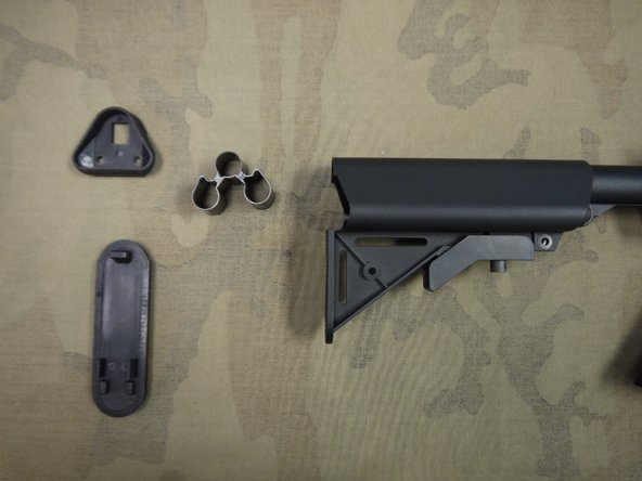

  20. G&G TR16 R4 Airsoft Reassembly: step 21, image 1 of 3 G&G TR16 R4 Airsoft Reassembly: step 21, image 2 of 3 G&G TR16 R4 Airsoft Reassembly: step 21, image 3 of 3
    • Now you can add the sling adapter and buffer-tube to the back of the AEG.
    • Start with the sling adapter. The protruding section go into the AEG and the wiring goes threw the middle.
    • Then with the wiring going threw the in slide the buffer-tube on to the back page of the body.
    • Then grab the large bolt with the washer piece attached and slide them into the back of the buffer-tube with the wring set underneath. Once the bolt is as far as it will go start screwing down the bolt using a long Philips screw driver.
    Ask FixBot

    • Now without pinching the wires coming out of the back of the buffer-tube slide the stock back on.
    • To do this pull down word on the stock adjustment leaver.
    • Now you can add the remaining stock pieces as well as your battery and test fire the gun.
    • Have fun!
