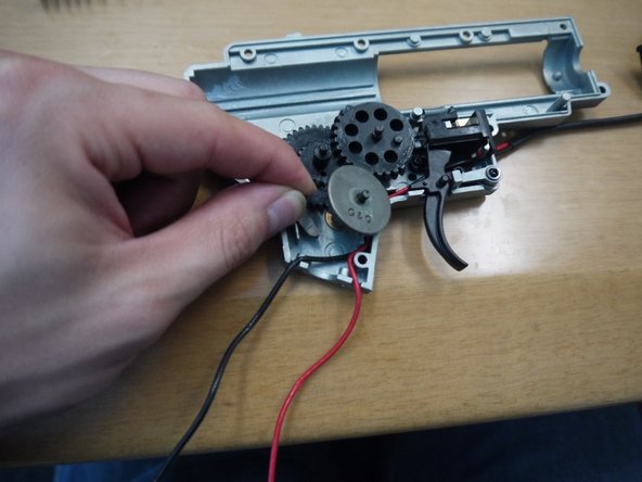

  4. G&G CM16 Carbine Airsoft Reassembly: step 4, image 1 of 3 G&G CM16 Carbine Airsoft Reassembly: step 4, image 2 of 3 G&G CM16 Carbine Airsoft Reassembly: step 4, image 3 of 3
    • Place the gears back in the gearbox starting with the spur gear. Check to make sure that there are no loose shims around.
    • Before installing the bevel gear, place the anti-reversal latch in and turn it clockwise so that spring tension will push it up against the bevel gear. Refer to the third picture and be sure you are installing it exactly as shown.
