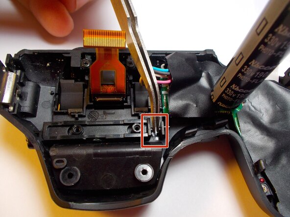

  5. Fujifilm FinePix S2980 Flash Mechanism Latch Spring Replacement: step 5, image 1 of 1
    • Remove two silver plated screw from under the top of the camera, under the flash.

  6. Fujifilm FinePix S2980 Flash Mechanism Latch Spring Replacement: step 6, image 1 of 1
    • Remove the rectangular plastic piece.

  7. Fujifilm FinePix S2980 Flash Mechanism Latch Spring Replacement: step 7, image 1 of 1
    • Insert new spring.
    • Replace the plastic piece.
