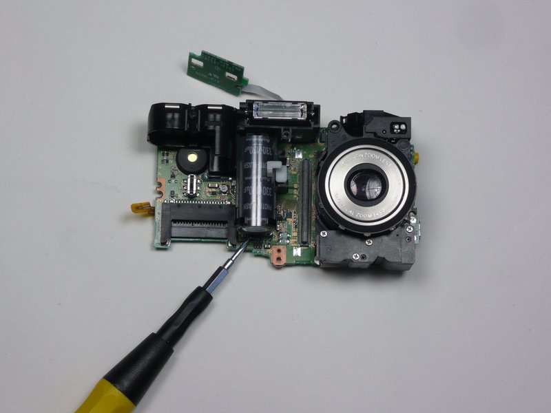

    1. FujiFilm FinePix A340 Flash Unit Replacement, Flash Unit: step 13, image 1 of 1
      • Locate the flash unit of the camera. It includes the camera's flash and a capacitor.
      Ask FixBot
    2. FujiFilm FinePix A340 Flash Unit Replacement: step 14, image 1 of 2 FujiFilm FinePix A340 Flash Unit Replacement: step 14, image 2 of 2
      • Desolder the flash unit at its three points.
      • Be careful not to damage the circuit board or surrounding parts with the solder iron.
      • Learn more about electronics soldering here.
      Ask FixBot
