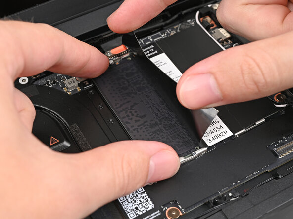

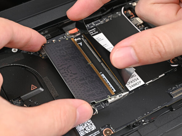

    1. Framework Laptop 13 Pro DDR5 SO-DIMM Memory Replacement, Remove the DDR5 Memory: step 7, image 1 of 3 Framework Laptop 13 Pro DDR5 SO-DIMM Memory Replacement, Remove the DDR5 Memory: step 7, image 2 of 3 Framework Laptop 13 Pro DDR5 SO-DIMM Memory Replacement, Remove the DDR5 Memory: step 7, image 3 of 3
      • While holding up the black flap covering the left memory module, push the two metal arms on each side of the module outward until they disengage and the module pops up at a shallow angle.
      • Slide the memory module out of its socket and remove it.
      Ask FixBot

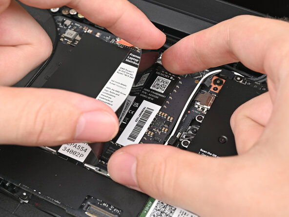

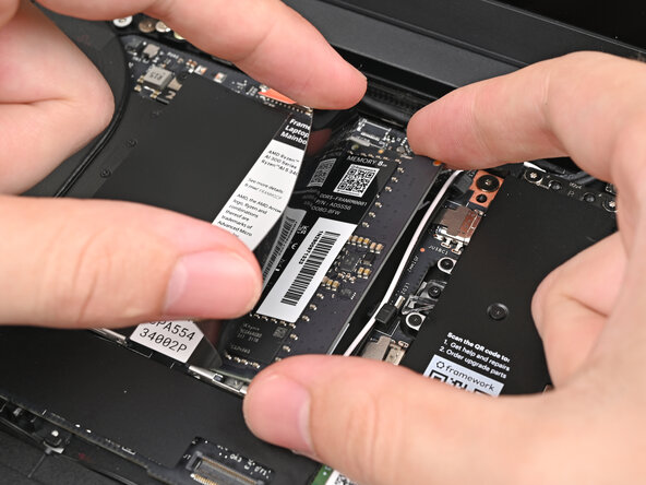

    2. Framework Laptop 13 Pro DDR5 SO-DIMM Memory Replacement: step 8, image 1 of 3 Framework Laptop 13 Pro DDR5 SO-DIMM Memory Replacement: step 8, image 2 of 3 Framework Laptop 13 Pro DDR5 SO-DIMM Memory Replacement: step 8, image 3 of 3
      • Repeat the previous step for the right module.
      Ask FixBot

    1. Framework Laptop 13 Pro DDR5 SO-DIMM Memory Replacement, Install the DDR5 Memory: step 10, image 1 of 3 Framework Laptop 13 Pro DDR5 SO-DIMM Memory Replacement, Install the DDR5 Memory: step 10, image 2 of 3 Framework Laptop 13 Pro DDR5 SO-DIMM Memory Replacement, Install the DDR5 Memory: step 10, image 3 of 3
      • Hold the memory module by its edges. Don't touch the gold contacts with your fingers. If you do, wipe the contacts with a clean, lint-free cloth to remove any finger oils.
      • While holding up the black flap covering the left memory module, orient the module with its label facing down and align the gold contacts with the left socket.
      • Insert the contact edge into the socket at a shallow angle. The gold contacts should mostly be covered by the socket.
      • Press the edges of the module down until the side clips lock it in place.
      Ask FixBot
    2. Framework Laptop 13 Pro DDR5 SO-DIMM Memory Replacement: step 11, image 1 of 3 Framework Laptop 13 Pro DDR5 SO-DIMM Memory Replacement: step 11, image 2 of 3 Framework Laptop 13 Pro DDR5 SO-DIMM Memory Replacement: step 11, image 3 of 3
      • Repeat the previous step for the right socket, except orient the module so its label is facing upward.
      Ask FixBot
