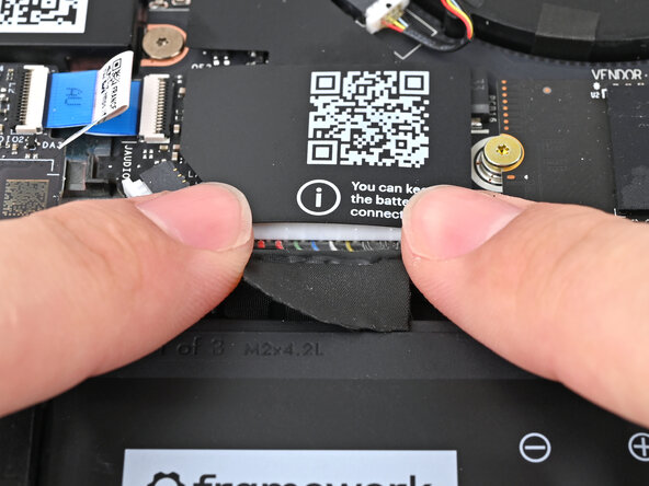

    1. Framework Laptop 13 Battery Replacement, Disconnect the Battery: step 7, image 1 of 2 Framework Laptop 13 Battery Replacement, Disconnect the Battery: step 7, image 2 of 2
      • When disconnecting the Battery, make sure you slide its connector straight out of its socket or else you risk bending the socket's pins.
      • Use your fingers to grip the edges of the Battery connector and slide it straight out of its socket to disconnect the Battery.
      Ask FixBot

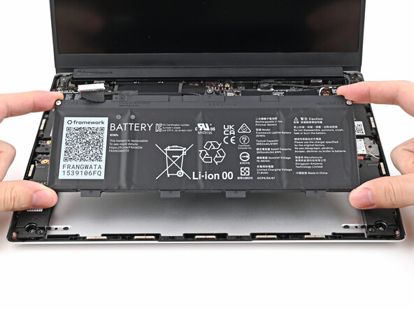

    3. Framework Laptop 13 Battery Replacement, Remove the Battery: step 9, image 1 of 3 Framework Laptop 13 Battery Replacement, Remove the Battery: step 9, image 2 of 3 Framework Laptop 13 Battery Replacement, Remove the Battery: step 9, image 3 of 3
      • Only handle the Battery by its plastic frame, making sure you don't bend or puncture it.
      • Lift the Battery towards the top edge of the laptop to slide its plastic tabs out of the Bottom Cover.
      • Remove the Battery.

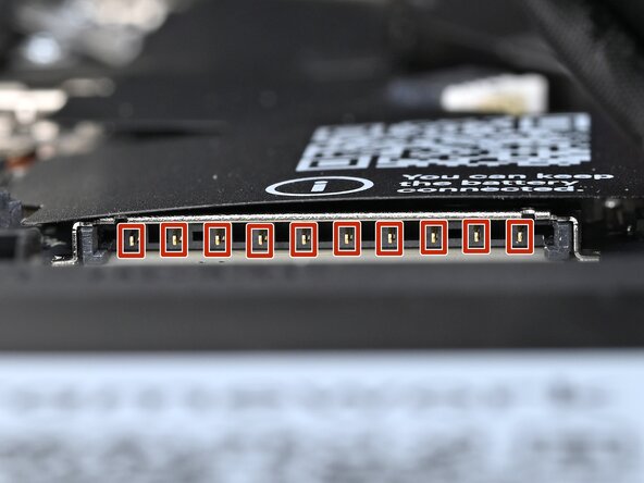

    3. Framework Laptop 13 Battery Replacement, Check the Battery socket: step 13, image 1 of 2 Framework Laptop 13 Battery Replacement, Check the Battery socket: step 13, image 2 of 2
      • Before continuing, check the pins on the battery socket and make sure they aren't bent.
      • If any of the pins are bent, reach out to Framework Support.
      Ask FixBot
