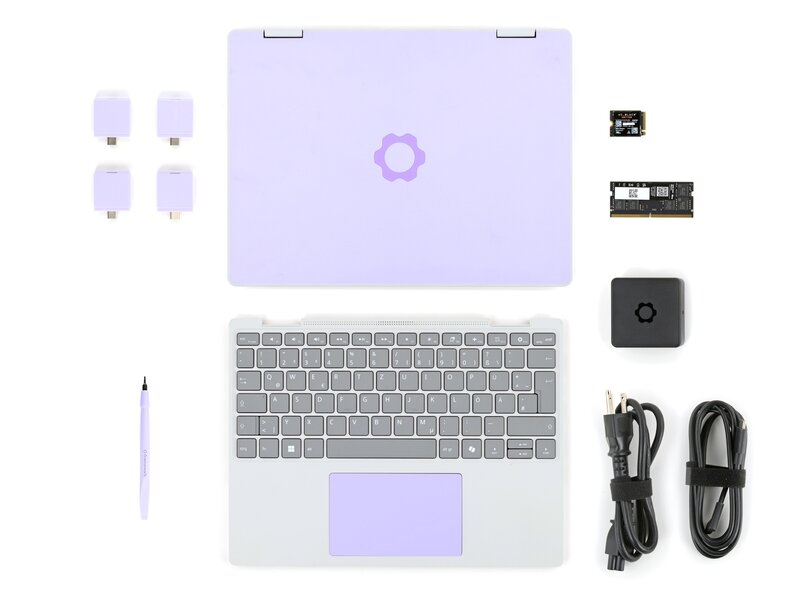

    1. Framework Laptop 12 DIY Edition Quick Start Guide, Unbox your Framework Laptop: step 1, image 1 of 2 Framework Laptop 12 DIY Edition Quick Start Guide, Unbox your Framework Laptop: step 1, image 2 of 2
      • Unbox your Framework Laptop and make sure you've received the following items:
      • Input Cover of your choice
      • Framework Screwdriver
      • Additionally, make sure you've received the optional items you purchased with your Framework Laptop:
      • SSD
      • Memory module
      • Expansion Card(s)
      • Framework Power Adapter, USB-C Cable, and AC Cable
