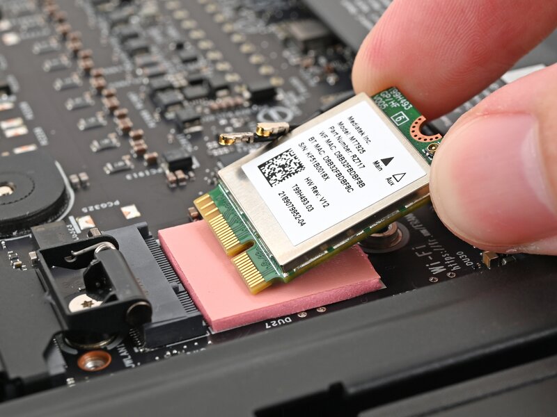

    1. Framework Desktop Wi-Fi Module Replacement, Install the Wi-Fi module: step 13, image 1 of 2 Framework Desktop Wi-Fi Module Replacement, Install the Wi-Fi module: step 13, image 2 of 2
      • Hold the Wi-Fi module by its edges. Don't touch the gold contacts with your fingers. If you do, wipe the contacts with a clean, lint-free cloth to remove any finger oils.
      • Align the Wi-Fi module's gold contacts and notch with the socket on the Mainboard.
      • Insert the Wi-Fi module into the socket at a shallow angle. The gold contacts should mostly be covered by the socket.
      • The Wi-Fi module fits into the socket in one orientation. If it doesn't fit, try flipping the module.

    2. Framework Desktop Wi-Fi Module Replacement, Connect the Wi-Fi Module: step 14, image 1 of 3 Framework Desktop Wi-Fi Module Replacement, Connect the Wi-Fi Module: step 14, image 2 of 3 Framework Desktop Wi-Fi Module Replacement, Connect the Wi-Fi Module: step 14, image 3 of 3
      • Hold the Wi-Fi module down with your fingers.
      • Position the black antenna cable connector over the left Wi-Fi module's coaxial socket.
      • Tweezers can help position the connector.
      • Use your finger to press the connector into place. You should feel a faint click, and the cable will stay attached to the socket by itself.
      • These connectors are very delicate! If the connector doesn't feel like it's clicking in place, reposition the connector and try again.
      • Repeat the procedure with the white antenna cable.
