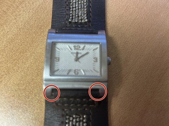

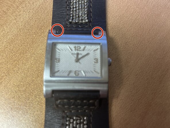

    1. Fossil JR-8997 Battery Replacement, Take out springbars: step 1, image 1 of 2 Fossil JR-8997 Battery Replacement, Take out springbars: step 1, image 2 of 2
      • Using a springbar tool take the first and then the second springbar

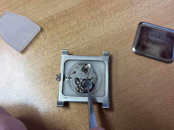

    1. Fossil JR-8997 Battery Replacement, Remove caseback: step 3, image 1 of 1
      • At the top right corner of the case there is a lip used for opening the caseback with a caseback opening tool
      Ask FixBot
    2. Fossil JR-8997 Battery Replacement, Take out old battery: step 4, image 1 of 1
      • Using tweezers carefully take out the old battery
      Ask FixBot
    3. Fossil JR-8997 Battery Replacement, Put  in new battery: step 5, image 1 of 1
      • Insert the new 377 cell battery into the watch
