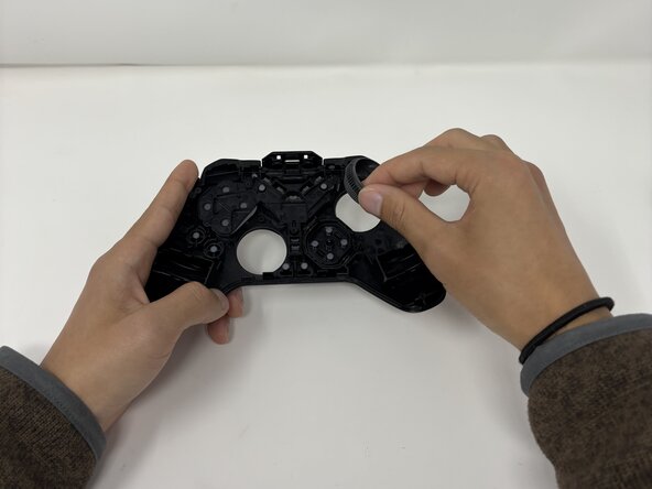

    1. Flydigi Vader 4 Pro Tension Adjustment Ring Replacement, Tension Adjustment Ring: step 8, image 1 of 3 Flydigi Vader 4 Pro Tension Adjustment Ring Replacement, Tension Adjustment Ring: step 8, image 2 of 3 Flydigi Vader 4 Pro Tension Adjustment Ring Replacement, Tension Adjustment Ring: step 8, image 3 of 3
      • Remove the tension adjustment ring.
