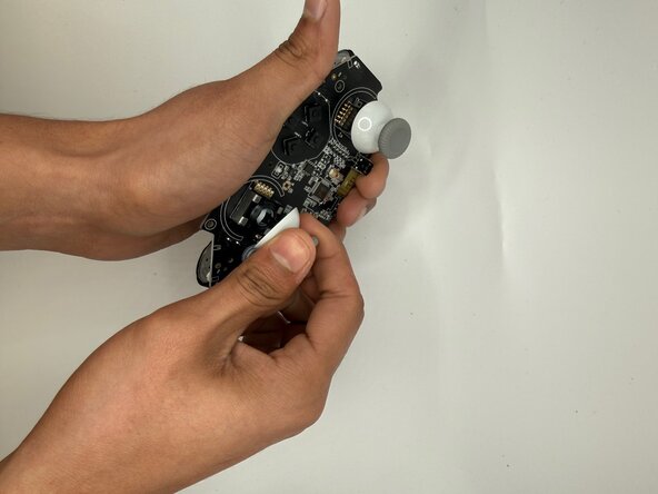

    1. Flydigi Direwolf 2 Joystick Cover Replacement, Joystick Cover: step 7, image 1 of 2 Flydigi Direwolf 2 Joystick Cover Replacement, Joystick Cover: step 7, image 2 of 2
      • Pull the joystick covers straight up to remove them.
      • Pulling them to the sides can damage them.
