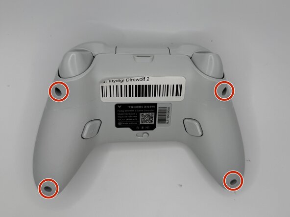

    1. Flydigi Direwolf 2 Action Buttons Replacement, Rear Case: step 1, image 1 of 1
      • Remove the four 10 mm-long Phillips 10mm screws securing the rear case to the front case.
      Ask FixBot
    2. Flydigi Direwolf 2 Action Buttons Replacement: step 2, image 1 of 3 Flydigi Direwolf 2 Action Buttons Replacement: step 2, image 2 of 3 Flydigi Direwolf 2 Action Buttons Replacement: step 2, image 3 of 3
      • Insert an opening pick into the seam between the rear and front case.
      • Slide the pick around the perimeter of the controller until the two halves of the controller release.
      • Remove the rear case.

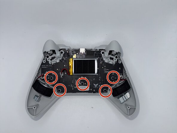

    1. Flydigi Direwolf 2 Action Buttons Replacement, Motherboard: step 5, image 1 of 2 Flydigi Direwolf 2 Action Buttons Replacement, Motherboard: step 5, image 2 of 2
      • Remove the five 10 mm Phillips screws securing the motherboard.
      • Remove the four 10 mm Phillips securing the triggers.
      Ask FixBot
    2. Flydigi Direwolf 2 Action Buttons Replacement: step 6, image 1 of 2 Flydigi Direwolf 2 Action Buttons Replacement: step 6, image 2 of 2
      • Remove both of the triggers from the top of the controller.
      • Lift the motherboard by holding it from the top and bottom of the controller.
      • The action buttons (A,B,X,Y) are loose and will fall out of the front panel if the controller is not kept face down properly.
