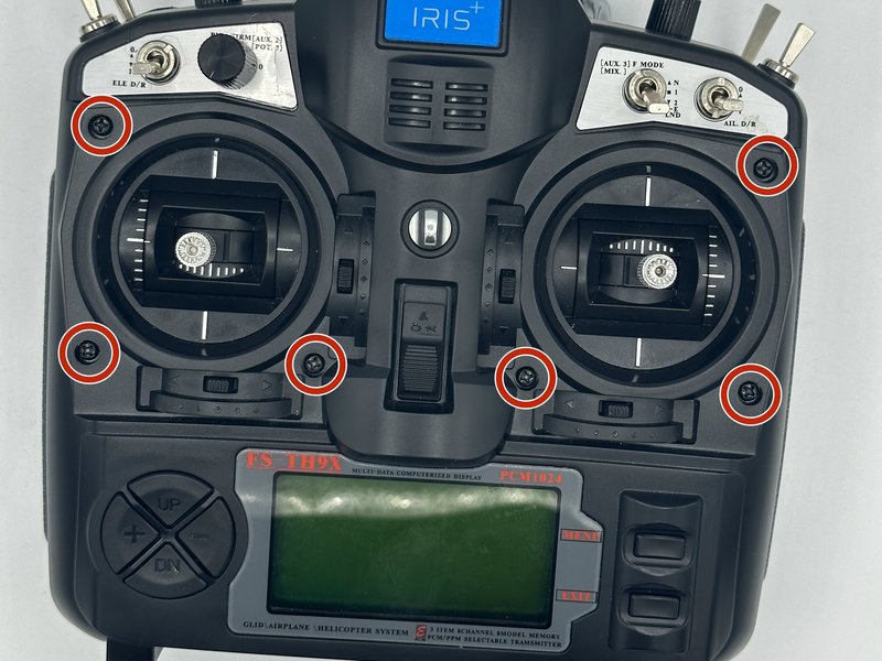

Over continued use, the joystick tends to move on it's own without you moving the joystick. This is fixable by replacing the entire joystick. This guide consist of the steps required to open the remote, dislocate the joysticks and than replacing said joysticks.

    1. FlySky FS-TH9X Joystick Replacement, FlySky FS-TH9X Disassembly: step 1, image 1 of 1
      • On the back of the remote, you will see 6 5mm Phillips #2 head screws.
      • The six screws on the front of the remote are screws that disconnect the joysticks from the remote and cannot be used to remove the back panel.
