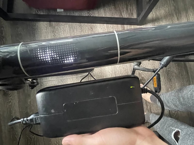

    1. Fix for Vanmoof S2 Not Charging, Bike not charging when plugged in: step 1, image 1 of 1
      • Under normal conditions, when plugged in and not fully charged, the light on the charger should turn red.
      • If it stays green (as shown) even while the bike itself indicates charging, the solution below will probably work for you.
      Ask FixBot
      • Vanmoof has a great video on how to remove the smart cartridge. You will need to buy the necessary Torx wrench because I don't think it comes with the bike.

Thank you. I'm not very skilled with such things, but it worked out pretty good and I didn't find it to complicated.
Marcel M - Reply Share
sure np I didn't think it was "difficult" either but the description of difficult said something like "requires soldering" so I put it as difficult 🤷‍♂️
Coleman Oei - Reply Share
Fiddly but not complex. I was using a soldering iron for the first time and just about managed it. Thanks for the post.
Three Sea Shells - Reply Share
