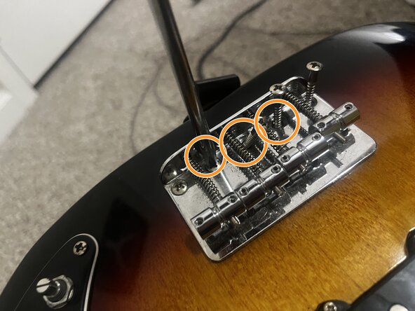

    5. Fender Squier Electric Bass Bridge Replacement: step 5, image 1 of 2 Fender Squier Electric Bass Bridge Replacement: step 5, image 2 of 2
      • Locate the screws on the outside of the string to begin adjusting the cylinders on the bridge (called bridge saddles).
      • Adjust the bridge saddles' proximity to the pickups by tightening or loosening the screws with your Phillips #1 screwdriver. Think of adjusting the bridge saddles as adjusting the action on the other end of the guitar.
