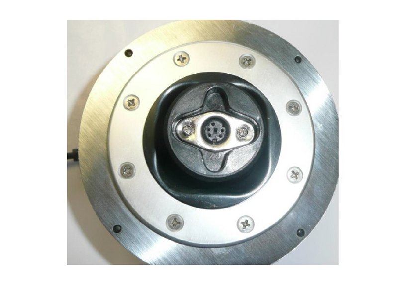

    1. Female DIN connector, Open the base: step 1, image 1 of 3 Female DIN connector, Open the base: step 1, image 2 of 3 Female DIN connector, Open the base: step 1, image 3 of 3
      • Remove 4 screws highlighted on the first picture.
      • Unplug the white connector highlighted in the second picture.
      • Remove 2 screws highlighted in 3rd picture.
