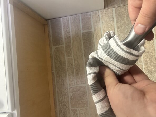

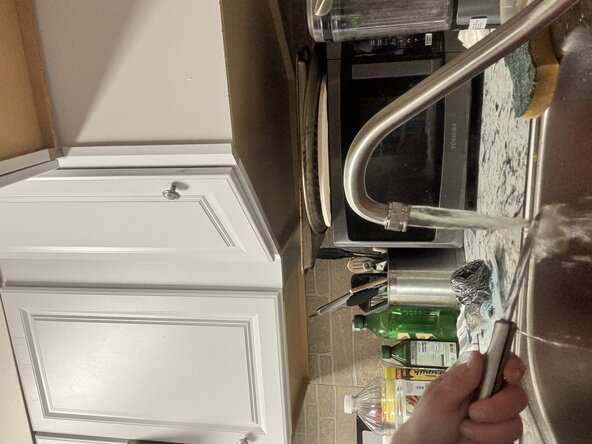

    4. Faberware Kitchen Knife Rust Removal/Blade Sharpening: step 4, image 1 of 2 Faberware Kitchen Knife Rust Removal/Blade Sharpening: step 4, image 2 of 2
      • Rinse the knive(s) with warm water and dry thoroughly.
      Ask FixBot
      • Optional Step: apply a small amount of baking soda paste to the blade. Rinse in warm water and wipe it clean again. This can neutralize acidity and help prevent further rusting.
