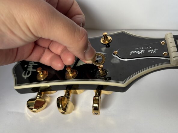

    3. Epiphone Les Paul Custom Tuning Keys Replacement: step 3, image 1 of 3 Epiphone Les Paul Custom Tuning Keys Replacement: step 3, image 2 of 3 Epiphone Les Paul Custom Tuning Keys Replacement: step 3, image 3 of 3
      • Using a 10mm sized wrench or socket wrench, place it over the threaded nut on the tuning key being replaced.
      • Turn the wrench until the nut is loose enough to be removed.
      • Remove the threaded nut and the washer beneath the nut from the guitar head.
      • Set these two pieces aside, just in case.

    4. Epiphone Les Paul Custom Tuning Keys Replacement: step 4, image 1 of 1
      • Flip the guitar over, so that the back of the guitar is now face up.
      • There are small screws still holding the tuning key in place. To remove these screws, use a #0 or #1 size Phillips screwdriver.
      • Place the removed screws aside.
      Ask FixBot
    5. Epiphone Les Paul Custom Tuning Keys Replacement: step 5, image 1 of 1
      • The tuning key can now be fully removed from the guitar head.
